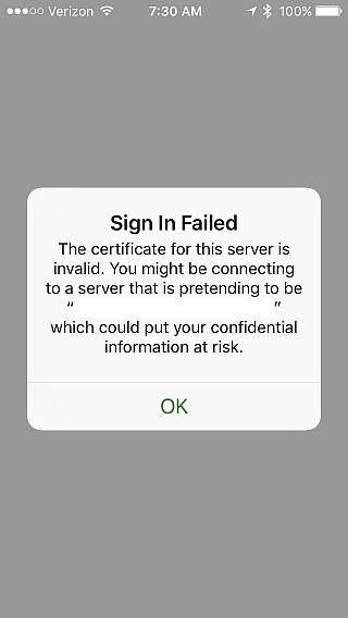

Hey Robert,
In regards to the following, can you send me a screenshot of the dialog you're seeing? ( [email protected] )
Thanks,
Joel
- IWA portal URLs not being added to the recent portal URL list on the portal Sign in screen -
   The most recent url is now being retained.
   NOTE** If a user swipes the app closed, they are shown a certificate error and forced to log back in again.
RobertHarris5
I realize that this is probably partly a result of our internal IIS and/or certificate settings. I would like to make clear that the latest version of Collector and the last 10.xx version of Exploer does/did not force a log out using the same settings and certs. Because our Portal is deployed behind our firewall we are using a domain authority to sign our certs. I have worked with ESRI support to try to meet all the necessary requirements (SAN,SHA2) to get this new Explorer app to work with our certificate to no avail. While we are able to login, as soon as the user swipes the app closed they have to go through the login process once again. I believe this may be because we are unable to use a CA signed cert, which to my knowledge is what ESRI does most of their testing with.
This does not happen when we access our organizations ArcGIS Online account.
RobertHarris5
See attached. We have server 10.3.1, portal 10.4.1 (Not federated), and our web adaptors all behind our firewall. All users either have to be within our network or use VPN to access out network. I believe the certificate error is due to the type of certificate. We are using a domain cert since a CA cannot access our domain to authenticate a certificate. This issue was replicated by ESRI as a result of a support ticket. We are having a similar issue now with the latest version of Collector, except it will not let us in the app at all. Hopefully there can be some communication between the development teams.

Have you tried installing the root certificate on your iOS device?
I know that this can help address this problem as it tells the iOS system "we trust this server"
RobertHarris5
We have not. We may try it as a test on one device, but it doesn't really seem like a viable option for 100 devices without a good MDM program.
