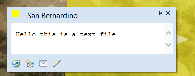

Using a shapefile in ArcGIS Explorer Desktop your attribute would need to look like this for a local file.
file:///C:/Users/Public/Documents/note.txt
and you would have to specify it the layer properties.
The popup would then show the file in the popup window.
