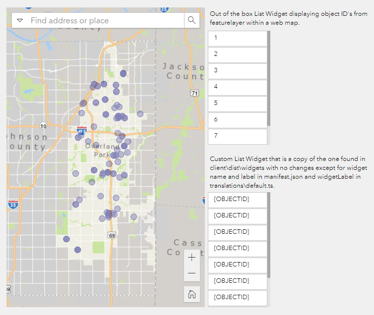

At the last User Conference, I asked if I could copy a widget from client\dist\widgets folder into client\your-extensions\widgets, rename it, and make changes.  I was told this was OK to do and I had no problems with arcgis-map and image widgets when I did that.  For the List Widget, I wanted to change the src\runtime\translations\default.ts listNoData value, but when I tried it the data did not seem to connect properly to the Text Widgets in the List Widget:

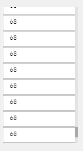

Also when I select a feature, all of the list items display the selected ObjectID:

We figured out the issue. It has to do with the expression builder component and how it reads the repeated data source provider. We need to make an enhancement to fix this. We are going to address this in the 9.2 release which is scheduled for the end of June.
