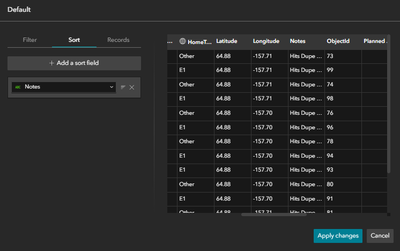

Unfortunately I've removed it the sort to get the zoom functionality again but here is the setup:

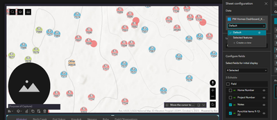

Here's what I've got - a table with 6 sheets that are feature layers (sorry the image cuts off the table below the map).  The data is sorted and several fields are hidden under configure fields. The sorting is to populate the table with the fields with data at the top. I've got allow editing on so I can take notes.
Each feature layer is grouped under 'Homes' and represents a different location.

I also covered cases of cluster feature layer, and hide field used for sorting. It is kind of challenging for me to understand the data structure in your case as the screenshots are not quite intact. It would be great if you could add more info to this case (any critical steps I missed, sample public app, screen recording). Thanks!
