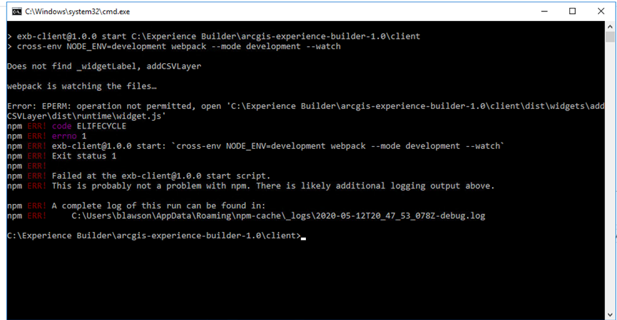

Why not running Experience Builder npm in administration mode fails?
3777
05-13-2020 07:15 AM
BrettLawson
I no longer have administration rights to a machine on which Experience Builder is installed, but it I don't run command prompt as Administrator I get the error below and to contents of the log follow.
Is there a way around having to run as administrator?

BrettLawson
For anybody else who has this problem, have someone with administration privileges delete any custom widgets from [install directory]\client\dist\widgets folder and then restart the client npm script.
BrettLawson
Anneley_Hadland
Hi I'm still getting this issue, I don't have any custom widgets, just the standard download. I am running cmd as Administrator. Please advise.
