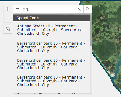

I used the Esri sample widgets 'editor' and 'js-api-widget' as starting points to create a simple custom Search widget. It simply embeds the JSAPI Search widget in the ExB widget (the code is attached for v 1.1). I got a reasonable result except for one thing. The dropdown list of search candidates does not overflow the parent div (class="widget-content"). This is demonstrated in the picture below where the ExBuilder widget has a red outline - the 3rd address candidate in the dropdown list is cut off.
This is a problem when this custom widget is placed above a map. Either it has to be placed way above the map to leave room for the dropdown, or it has to be placed partly in front of the map. The problem with having part of the widget in front of the map is that it prevents that part of the map from being clicked on.

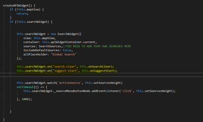

I experienced the same issue, I have put in some listeners to change the size of the widget to allow the dropdowns and and the suggestions to display properly. Its seems to work ok, i have also pushed my search source out in to a seperate file. See the attached and what it looks like in a map below.

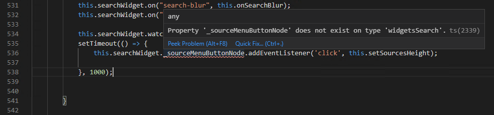

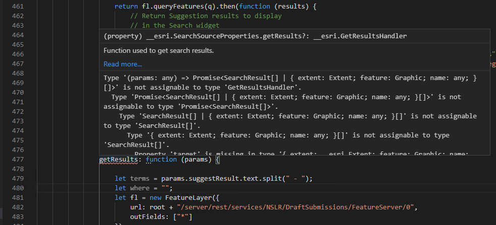

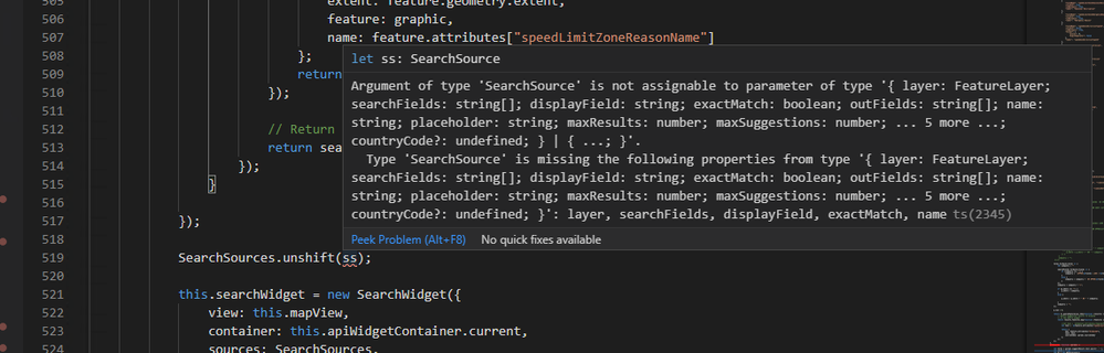

Thanks, Grant.  I tried unzipping the folder in my "your-extensions" folder.  In VS Code I am seeing a few error warnings.  I encountered 1 less in ExB 1.2, but manifest.json says exbVersion 1.1.  Am I missing something?
Line 477
Line 519
Line 536

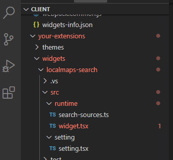

Ok a couple of things, in your folder structure, it looks like the search has been nested under YourExtensions\search\localmaps-search it will need to be YoruExtensions\localmaps-search.
I was also using a custom search source in that example, so hence why there are is the extra search source I am creating. The important parts for what you are trying to achieve are the highlighted lines below. There are the listeners which will get triggered to grow the size of the widget to show all the suggestions.

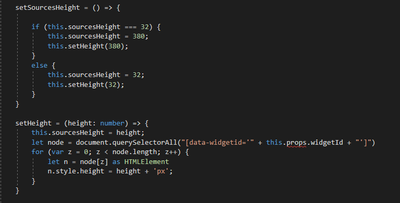

Which refers to these methods.

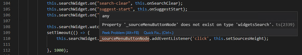

Thanks, Grant.  I had tried the folder structure both ways before with the same result.  This version is better, but I still get one error in ExB v1.2 (two errors in v.1.1).
Everything is green in the console, so all is good there.  I just can't find anything on
_sourceMenuButtonNode.
Are you using VS Code?  Which version of ExB?

Hi Dave, the _sourceMenuButtonNode is a private property on the Search Widget, when you are debugging, you can inspect the properties of the SearchWidget and find it. This is the dropdown button which lets you select which search source you want to use.
Is the error preventing webpack from packing the .tsx files? I'm using Visual Studio 2019, I get the same warning, but it does not prevent the files from compiling. I am also using ExB 1.2, however, i built this widget in 1.1.
If you are not concerned with letting people chose a search source, then you can remove the code related to the search source drop down.
Cheers
DaveFullerton
Thanks, Grant.  I have seen no errors from webpack.  There was an error in Chrome's developer tools, and I was looking for the _sourceMenuButtonNode but couldn't find it.  It turns out that when there is only one source, there is no dropdown button for selecting which source you want to use.  I added a second source and it now works without errors.
