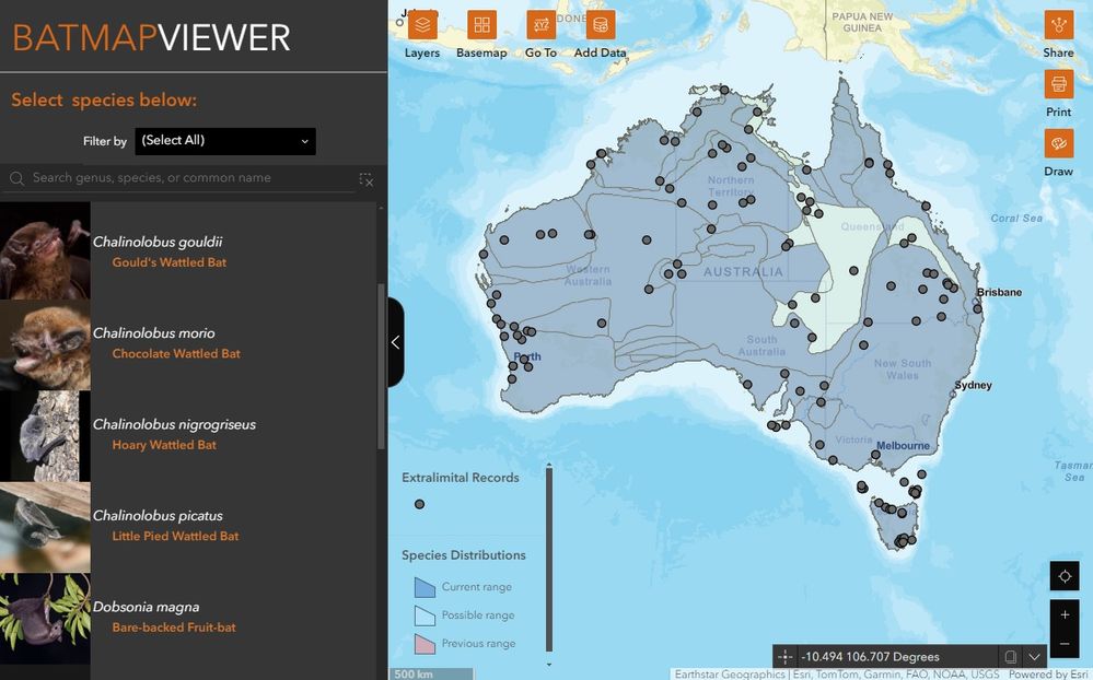

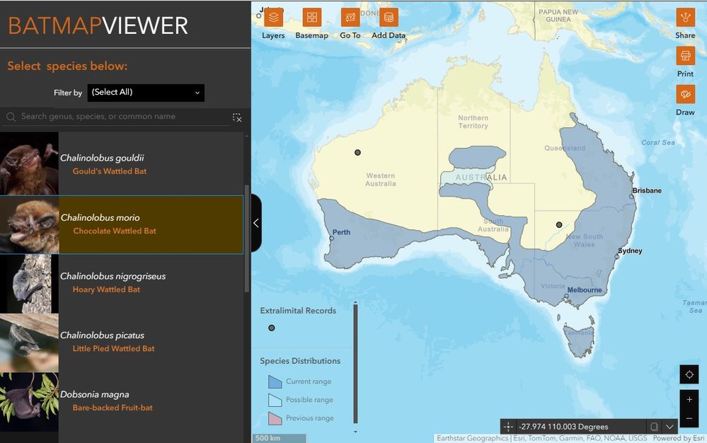

I have a List Widget and a Map Widget. The two Widgets are linked so that when a user clicks on a record in my List Widget, it filters the corrosponding data in my Map Widget (Figure 1). When no records are selected in my List Widget, no filters are applied and all of my data is displayed in my Map Widget by default (Figure 2). I'm trying to change this behaviour so that when no records are selected in my List Widget, no data is displayed in my Map Widget by default (i.e. only base map is displayed).
Does anyone know how to do this?

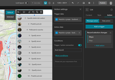

would it be possible for you to completely omit the Filter widget and use just the List widget and its filtering message action?
See my samle below

I see your point now. I am not sure how to achieve this with out of the box widgets. I can imagine it would be quite easy customization to the List widget but you would need to use Experience Builder Developer edition, adn then host the app on your webserver or hsot the customized widget on Portal for ArcGIS.
Maybe others can sugegst some better approach.
