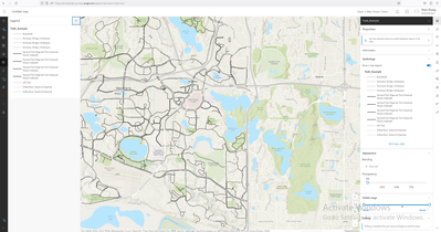

I have been quietly living with a problem for many years and I'm finally sick of dealing with it. In my publishing document (Arc pro 3.1.1 in this case but it's happened in many versions of both Map and Pro), I take all the time to group together features by symbology to make them easier for end users/the public to interpret in the legend (GroupedInSymbology.jpg). When I add my published features service to a web map via REST endpoint, the legend looks as it should (GroupedInWebMap.jpg). But whenever grouped symbology layers like this are consumed in a web app (In this case Experience Builder 11.1 dev edition, but again I've had the same problem in ExB 1.7, 1.9, and various versions of Web AppBuilder), the software maintains the legend symbology but ungroups the values. The resulting list is very confusing because it does maintain the appropriate label, except each value gets the same label, so there are multiple entries of a particular label, all with the same symbol (UngroupedInWebApp.jpg).
As I said this has stumped me for a long time. Does anyone have any idea why this happens or if anything can be done?

Shen_Zhang
@ZachBodenner Thanks for the data provided. I published a feature service with data you provided, seems same problem also existed in Map Viewer:
I tried to add this layer to Map Viewer Classic, it turns out working fine - were you using Map Viewer Classic in the screenshot which legend looks as it should?
It could be Javascript api bug - since Map Viewer and Experience builder are both using the latest version of JS API.

TonghuiMing
Hi @ZachBodenner
Sorry that you have been experiencing this issue. Per the detailed investigation from us and the JS API team, the problem lies in ArcGIS Pro - when you add the published data back to Pro, it also has the same issue.
We will notify the corresponding team about this and they will help fix it. In the meantime, you can post the question on the ArcGIS Pro Community channel if you'd like.
Thanks for bringing this up.
