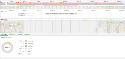

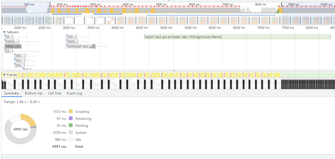

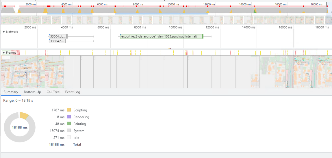

Upon testing the Web Map on its own in Portal Map Viewer the performance is better, although not great, it gives about 13FPS as seen in Dev Tools, while when using the same Web Map in a Blank Template with just the Map widget there is 1FPS, just panning.
Panning in Web Map Viewer in Portal (10.9.1):
Panning in Web Map in ExB (1.9) Dev Edition, Blank Template, just Map Widget:
