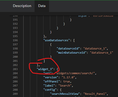

I do not see how to identify the search widget_# in the ArcGIS Assistant nor do I see a widget_# in experience builder. Does ESRI have a widget that helps expose the actual URL Parameters because this guessing of widget numbers is not well done. It just should not be this difficult, it was certainly easier in web app builder.
WorcesterGTSS
I'm not going to argue that it should be easier to find the widget #s!
I found it by going into ArcGIS Assistant, clicking on the Experience Builder app in question, then clicking on View Item JSON from the Item Details pane that appears, and then clicking on the Data tab.
