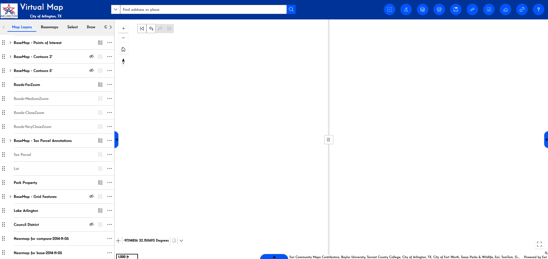

The Nearmap Widget uses a Swipe Widget from the Javascript API to allow comparison of aerial imagery. Major problems arise when activating the comparison feature.
Unmodified, using the Swipe Widget, activating the comparison mode turns the whole map area white.
