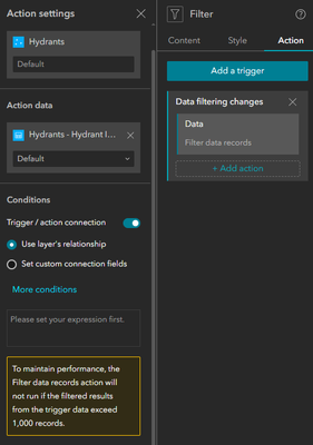

Hi @cboyerTucson ,
In the latest Feb 2026 AGOL release, we support selecting and filtering data records using the "Data filtering changes" trigger. This enhancement allows related layers to be filtered automatically when a filter is applied to the parent layer.
Please note that there is currently a limitation for performance considerations: the action will not run if the filtered results from the trigger data exceed 1,000 records.
Let me know if you have any questions or need further clarification.
