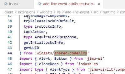

Hello everyone, I'm trying to import a component declared in the shared-code folder to my widget setting file but i always end up with this error :
Load module error. TypeError: window.require is not a function
My question is : is it already possible to consume components from the shared-code folder in the setting file of a widget ? if so how can I achieve that ?
