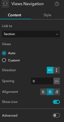

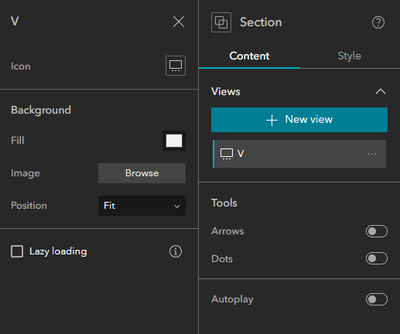

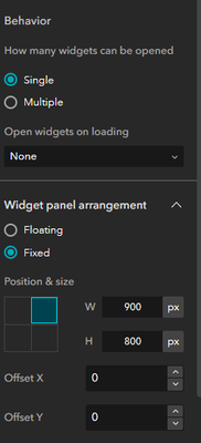

The best way to achieve this without Developer Edition is to place different Map Widgets into a Widget Controller. Use the Single widget and Fixed panel options. Then give each map a separate icon.
Something similar can be achieved with the Section and Views Navigation Widgets. With the Show Icon option in the Views Navigation Widget and setting the icon in the Section Widget, but it does not appear possible to make the Title blank.
JeffreyThompson2_0-1697202916221.pngJeffreyThompson2_0-1697202916221.pngJeffreyThompson2_1-1697202957107.pngJeffreyThompson2_1-1697202957107.png
You could also place your maps on separate pages, but the page names cannot be made blank either.

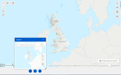

Widget Controller : It works very well, but when i click on one of each map widget in the controller, it's only show me a little windows with my map :
But i want to replace my big map in back with one of the maps selected in the controller widget, not to have a little windows like this. How can i change that ?

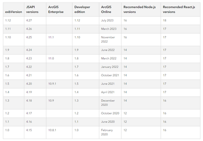

Upon further research, the ability to add icons in Views/Sections is a Experience Builder 1.12 addition. Enterprise is several versions behind on Experience Builder.
Some of these Widget Controller options also appear to be Experience Builder 1.12.

Well. I'm on Enterprise 1.11 but my ArcGIS Enterprise was installed in earlier September. Don't know why I do not have the lastest version (which be upload on July if I trust your screenshot).
But that's okay. I'm gonna see to upgrade my Enterprise to the lastest version and then, I can use your solution.

Enterprise 11.1 is on Experience Builder 1.10. When Enterprise 11.2 is released (next month?), it will be on Experience Builder 1.12. 1.12 was a big Experience Builder upgrade, but is it worth upgrading your entire organization for a few new Experience Builder options? That's up to your organization.
