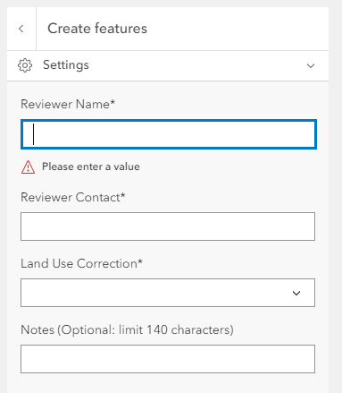

In the SmartEditor widget in WAB, you were able to set user defined preset values, which could come before the other field values to prevent the user from having to type in basic info each time.
Example:
In the current edit widget in Experience builder I do not see an option for similar functionality. Has this functionality been removed or will it be added?
Thank you!

Hi Alix,
Thank you for your reply. Unfortunately, I am still unsure how to allow each user to define preset values themselves. I see we can have hard-coded values and calculated values from other fields or from the map, but is it possible to accomplish what was accomplished in WAB Smart Editor above?
The users of the application (who do not have an AGOL account) will be placing several points over and over again on a map within an experience builder application and filling in other information for each point in the editor widget. It would be great if they only had to fill in their name and email one time to avoid duplicating effort on their part. Is this something I can enable with the editor widget and smart forms?
Thank you!
