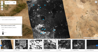

I would like to put together a simple app that uses the bookmarks saved in a webmap to present information to the user. I was looking for a template that would display the bookmarks.
When a user selects a bookmark, I would like the app to zoom to that extent, and display descriptive text about that location.
I've tried a bunch of different instant app templates, and a bunch of Experience Builder templates, and I have not been able to figure out how to link displayed text to the selection of a bookmark.
It seems like this should be fairly straightforward. Does anyone have any suggestions? The closest I've gotten to the layout I want is the Ribbon Experience Builder template, but I just can't figure out how to add dynamic text that connects to a selected Bookmark.
I've attached a screenshot of the layout I would like to use, if I could just figure out how to hook up the text components to the Bookmark selection.

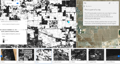

In the end, I combined the approach of using the Ribbon template to leverage the bookmarks, but added a feature service with icons that display in each of the bookmarks. Once a user clicks on a bookmark, they can click on the information icon to display a popup with the relevant information.
I'm pretty pleased with how it turned out, as it allowed me to use the pleasing layout of the Ribbon template (and easily provide access the swipe functionality), while making it easy to provide access to the relevant content. While I'd still prefer that the relevant content be displayed automatically when a user navigates to a bookmark, this is a fine compromise that didn't require a lot of troubleshooting to accomplish.
