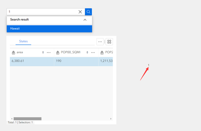

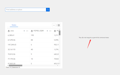

Hi  BronwenHughes,
Currently it is only possible to display records in the Text widget when they can be found. When the number of records is greater than or equal to 1, it means that ‘You require a permit to remove trees’ as you mentioned.
