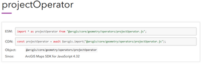

I think your issue relates to the compatibility between your Enterprise and the version of the JavaScript SDK it is compatible with.
ProjectOperator is a new feature in the API only added in 4.32. Enterprise will load the version of the JavaScript SDK it is compatible with. Unless you are on Enterprise 11.5, you will not be able to use projectOperator. And if you are, the chart is unclear.
https://developers.arcgis.com/experience-builder/guide/release-versions/
