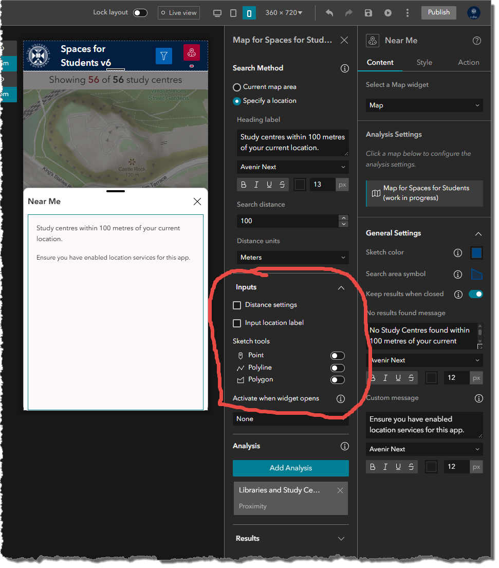

I'm creating an Experience that will be used on mobile devices to help students find nearby study spaces (buildings).  The problem I'm having is that I can't get the Near Me widget to use the users current location.  This seems like a basic requirement for the Near Me widget, so I presume it's something I'm missing or not doing right (unless this functionality doesn't exist?).

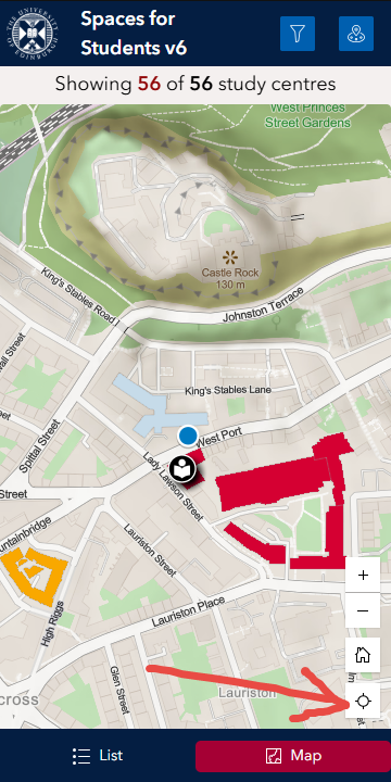

I'd like the Near Me widget to find all buildings within a set distance (100 metres) from the users current location.  The map is configured with the 'Locate' tool which works fine:
But I can't find any where of specifying that the users location should be used as the location to use in the Near Me widget.  It feels like we need another option/setting in the Inputs area for 'Users current location':
Does anyone know if this is possible in the current version of ArcGIS Online?  Or any workarounds?
