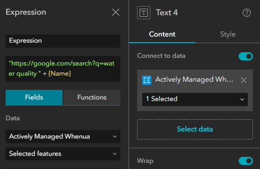

Hi there,
I'm just creating some dynamic links based on which observation is selected in a list widget (see example below). How would this expression be adapted so that it still works if nothing is selected (i.e. it just adds "" to the URL)? Currently if nothing is selected, the URL is "https://experience.arcgis.com/cdn/2429/experience/" (completely different).
Thanks in advance 🙂

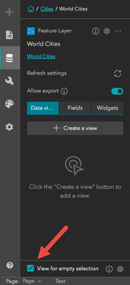

Hi @COwen ,
You can check the "View for empty selection" option in the Data panel.

COwen
Hi Shengdi,
Thanks for your suggestion. That is definitely better/closer except it now includes a 'Name' value even though nothing is selected.
Thanks,
Caitlin
