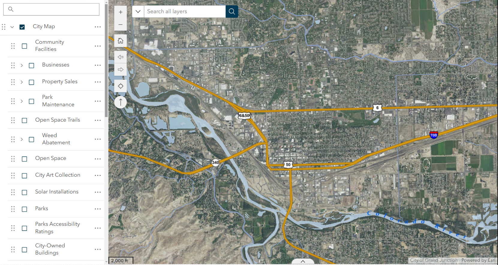

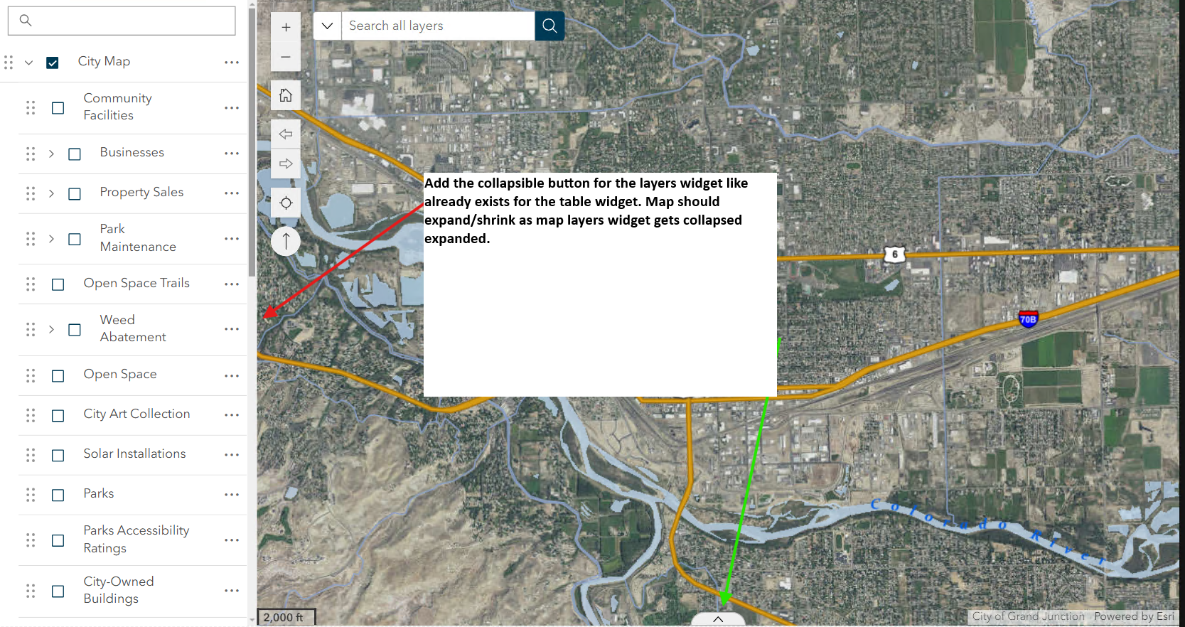

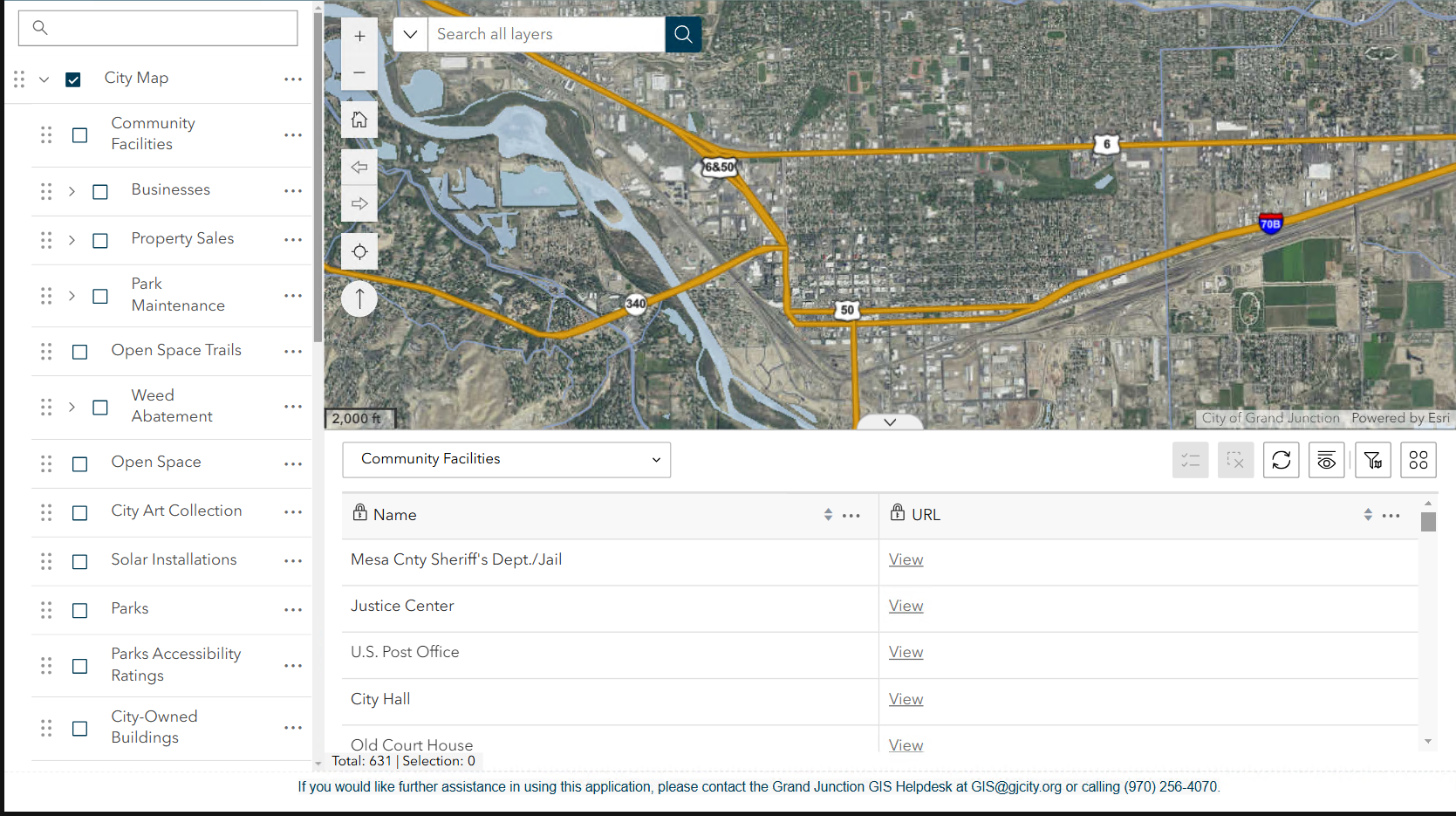

In the body of my experience, I have three main components; a map widget, table widget, and map layers widget.
The table widget can be expanded or collapsed, which in turn adjusts the map size.
I have tried a few approaches but have had no success adding this function to the map layers widget. Please let me know if anyone has a workflow or tips I might have missed.

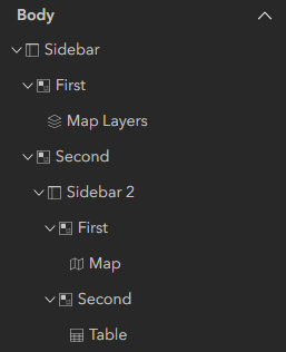

LucVanDijk
Hi @Brian_McLeer ,
Your goal can be accomplished by nesting multiple Sidebar widgets. You can nest as many of them as you like. Make sure the 'First' half of the Sidebar contains a widget (in this case, Map Layers) and the 'Second' half of the sidebar contains another Sidebar widget. The second Sidebar widget should then contain the Map and Table widgets. When nesting sidebars, always make sure to put the Map widget at the 'deepest' level.
You can change the configuration of the Sidebar widgets independently: make Sidebar 1 dock to the left and Sidebar 2 dock to the bottom. This also leads to the solution for @JasonBOCQUET 's problem: change the docking side to 'bottom':
This will make your table show/hide from the bottom of the screen. Set the 'size' parameter to the size you want your table to be when expanded. Do not set it to 0, as that will make it always invisible.

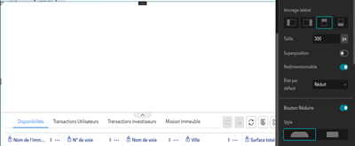

JasonBOCQUET
Hi @Brian_McLeer i'm sorry but I have not the answer to your question, i replied because I think you can help me.
I wanted to add a table in the sidebar widget, but i've one great problem :
here I can deploy and reduce without any problem, but i don't want to have a little part of my table showed, so i change the "Size" parameter to "0" but if I do that, my table do not reduce when I click on the arrow...
Can you share with me your parameter of this widget to make it work please ?

JasonBOCQUET
It works great ! thanks for your help 🙂
