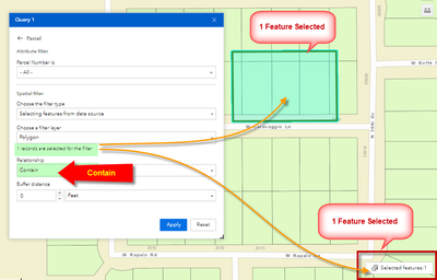

Once you have 1 feature selected and your Query Widget shows up like this you are ready to go.
When I hit Apply, the Query Widget correctly returns the 3 Parcels within the green polygon.
I am getting "Features displayed: 1- 3 / 3"
However, in your case, you are getting "Features displayed: 0 - 0 / 0"

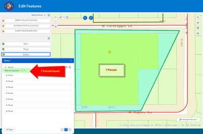

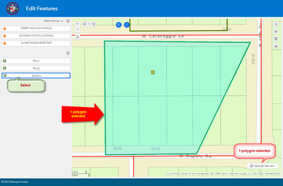

I just tried these steps on 3 different computers using the MyPoly Polygon you added.
It worked every time.
https://experience.arcgis.com/experience/826295ea0a7344699360f284308e7456/
I open the Parcel Query
Filter layer = Polygon
1 record selected in filter layer
Relationship = Contain
Apply
The Query Widget returns 7 Parcels within your MyPoly polygon
