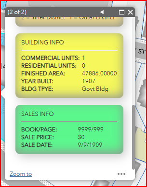

Here's how a table element looks with padding set to 10px in Web AppBuilder:

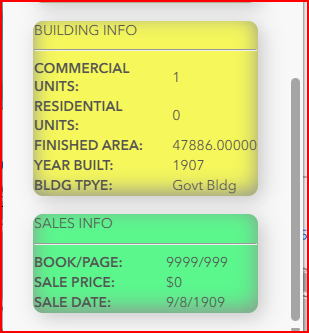

But padding in Experience Builder doesn't seem to work:

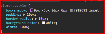

Here's the CSS for the table element that was set using ArcGIS Pro:

I hate to answer my own question but I think it's important to share what I found.  By moving the style properties in <table> to <div>, I was able to get the padding value to work.
