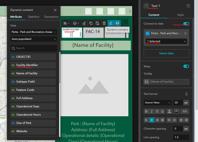

  • For this use list to show the trail markers buttons, and add data as your trails layer SumitZarkarCT_2-1648288645870.pngSumitZarkarCT_2-1648288645870.png
  • Remove all default elements of the list and add Text control to show the trail number. (Like FAC-12).  Select same layer so that you can set dynamic data in the text controlSumitZarkarCT_4-1648288912610.pngSumitZarkarCT_4-1648288912610.png

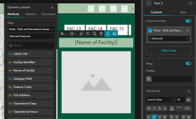

  • Add Text to show the title

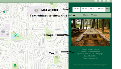

  • Add Image
  • Add Text and set dynamic/static text as per your requirement

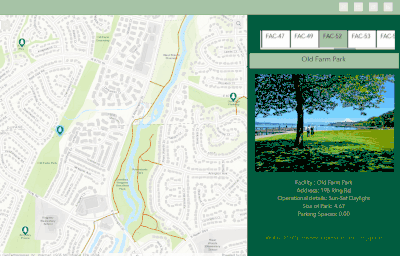

Here is the final Result:
