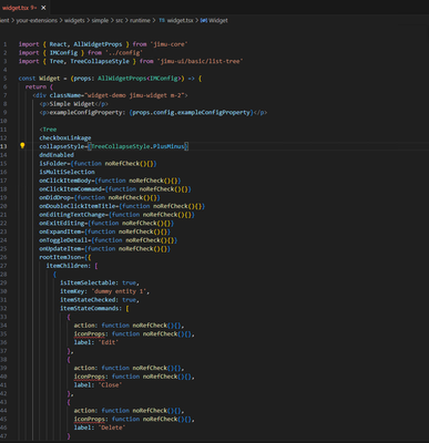

Hi
I was trying to use List Tree Control, but the collapse expand is not working when i try to implement in the widget, I copied code from this article https://developers.arcgis.com/experience-builder/storybook/?path=/docs/components-jimu-ui-basic-list... but expand collapse doesn't work, I tried this on developer edition 1.10, 1.13 but it's not working

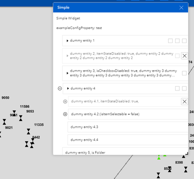

RachappaBellappa1
@TianWen I just copied the code snippet from storybook example and placed it inside the sample widget code. Please check the below screenshot

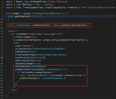

TianWen
Thanks for the screenshot!
1. The tree component is driven by data, and you can set default data initially.
2. Any interactions with the component will generate updated data, which will be returned via the update function.
You will then need to pass this updated data back to the component.
Please refer to the snippet below for details.

  const [rootItemJson, setRootItemJson] = React.useState(getItemsJson())
  return (
    <div className="widget-demo jimu-widget m-2">
      <p>Simple Widget</p>
      <p>exampleConfigProperty: {props.config.exampleConfigProperty}</p>
      <Tree
        size={'default'}
        collapseStyle={TreeCollapseStyle.PlusMinus}
        dndEnabled={false}
        treeAlignmentType={TreeAlignmentType.Typical}
        treeStyle={TreeStyle.Card}
        isMultiSelection={true}
        checkboxLinkage={true}
        rootItemJson={rootItemJson}
        onUpdateItem={(actionData, refComponent) => {
          if (actionData.changeItemJson) {
            const [nextRootItemJson] = actionData.itemJsons.slice(-1)
            setRootItemJson({ ...nextRootItemJson })
    </div>
