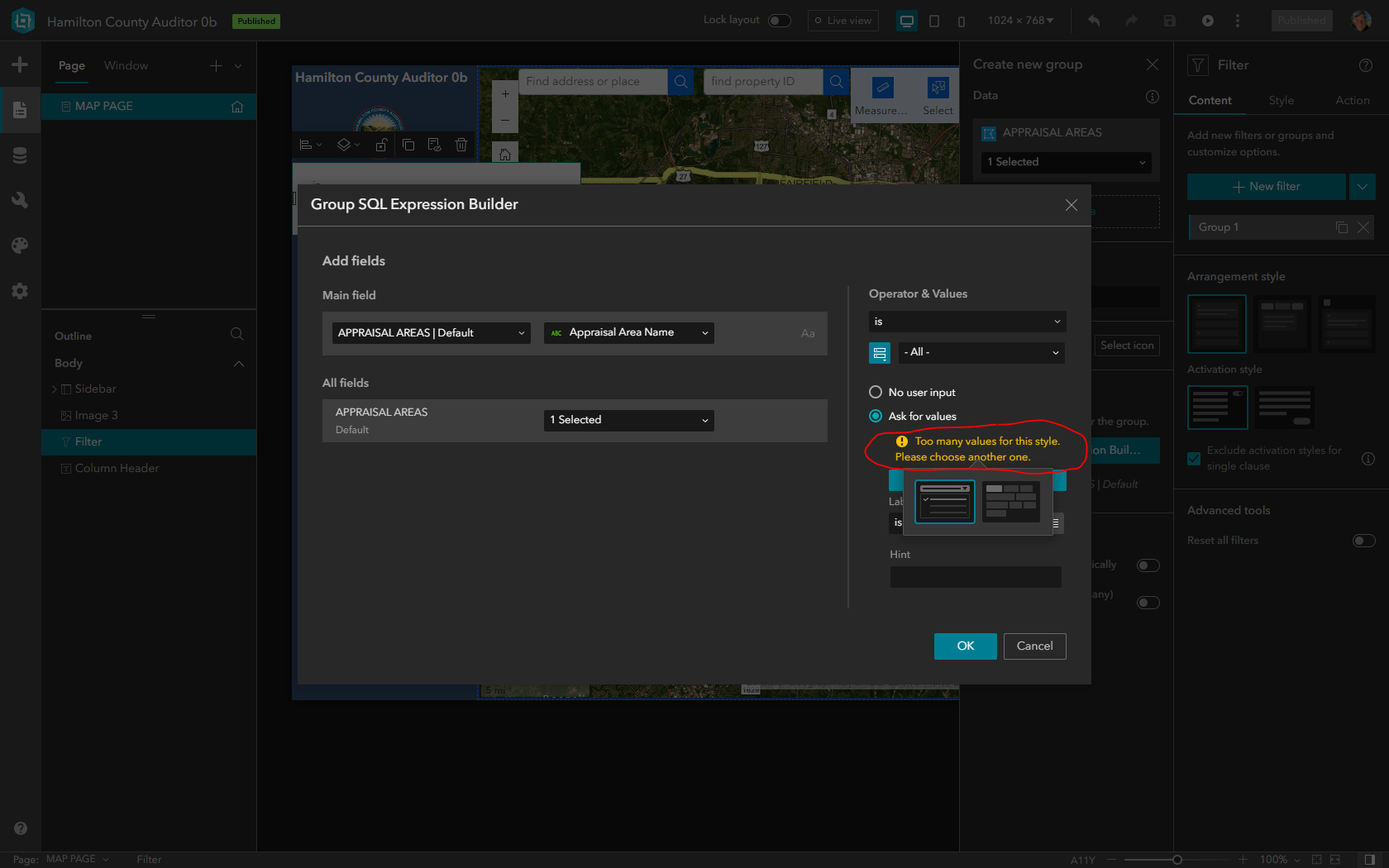

I got this set up quickly in AGOL Dashboards, but I can’t do it fully in Experience Builder. This limit within Experience builder can be seen in the attached image.
So what is the magic cut-off number?

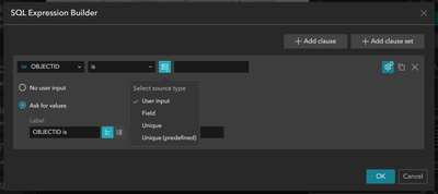

The Filter Widget has some limitation to the number of buttons it will create. I don't know the exact number, but your design would create way too many. The buttons would fill the entire screen and then some. I don't think the dropdown style has any such limitations, but for the sake of your users, use the User Input and Ask For Values Options. This will give them a text input which will be much easier to use than hunting through thousands of items in a dropdown.

Hi @TimothyHoeflich,
When Pill selector style is used, it has some limitation to the number. It is by design.
This style only applies to a small number of unique values, making it easy for the user to select values directly.

Hi @Ke_Xu
We have been experiencing the same warning about "too many values" when trying to use the pill selector in filter widget in experience builder (Enterprise 11.3).  Thank you for confirming that this is due to a built-in limitation.  What is the specific cutoff number for unique values that would enable use of the pill selector?  We have 30 unique values and would like to know if we are close to the cutoff, since we may be able to massage our data to fit this limit.
