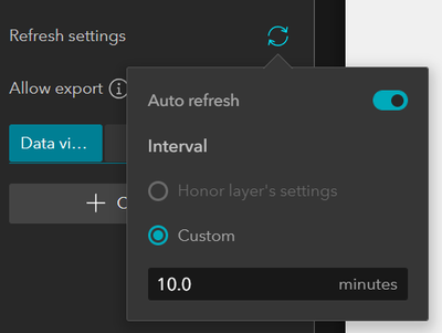

Currently, there are two options to refresh/update the data used in ExB:
1. Use the 'Auto refresh' option in the data source layer settings -
2. Refresh the entire app to update the data change.
Once loaded, the data should not be changed unless using these two methods.
