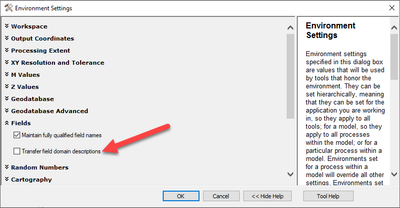

There is also this in ArcMap 10.6.1
Looks like it is for dxf files but once you get to this format you could then go to csv.
