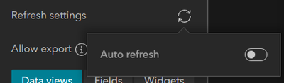

Hi @Alee_erickson, could you share a bit more information about how you configure the Timeline widget? Also, have you turned on the Refresh settings inside the Data source panel on the left side?

  • All time-enabled layers are set to auto-refresh
