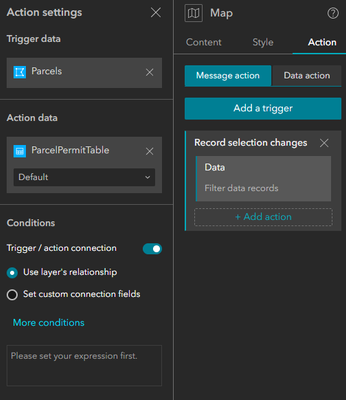

Besides, in the left list widget, you can add the following message action: Record selection changes - Data - Filter data records, and use the layer's relationship to build the connection. In this way, if a ticket is selected from the left list, the right list will be filtered to show only comments from that ticket.
