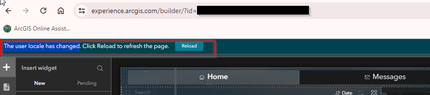

After the recent AGOL updates, I noticed this option when going to edit my experience builders. When I click 'Reload' it sits at the loading screen and never loads. After multiple refreshes it did not work. I had to clear the cache on my browser to get it to work, but then when I made any changes and published the experience builder, it got stuck on the loading screen again. Has anyone had issues with getting into experience builders after the last AGOL update?

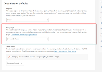

We found a fix that helped us. If you go to Organization -> General -> Organization defaults, you can set the Language to "Browser Default". Mine was set to US which is was causing the error. Changing it to Browser Default helped. @IoannisPapas , @RichardLittlefield , @HDR_wShrader , @James_Whitacre_PGC
Let me know if that works for you guys as well!

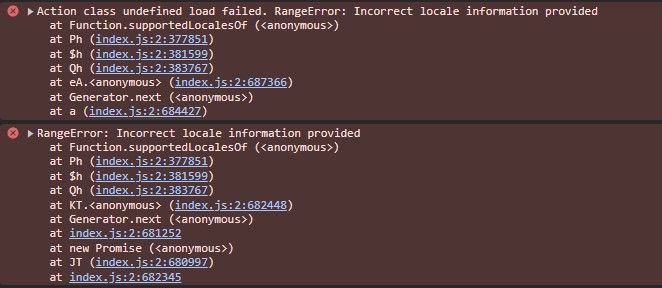

IoannisPapas
It happens to us also when trying to access the Experience Builder.
Also cleared the browser Cache but nothing changed.
I have attached a print screen of the error in the browser console window.Experience builder error.jpgExperience builder error.jpg
