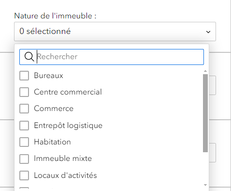

Hi community,
I'm here to ask to you if anyone have the same problem than me.
I explain : Here is my filter widget

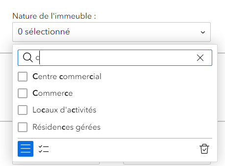

If I type "C" on the Researh bar i've this :

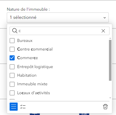

But, if I click on one tickbox to select one (for example Commerce) :
The research was reset and i'm forced to erase the "c" on the research textbar and type again to select another one.
So in this case the problem is not terrible, but i have a filter widget to search some society in France, and i would to allow to my user the possibility by using the research bar to tick multiple time on the widget without be forced to RETYPE each time their research. It's very not ergonomic to users.
Anyone have an idea of what can I do to avoid this problem ? Thanks !

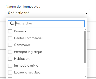

JasonBOCQUET
Hi @TonghuiMing i'm back on this subject. I've switched on the 1.15 dev edition and still have the problem... but only on this view.
I have the similar group filter on other view, there is no problem of typing reset; but on this view i still have the issue that the research function is reset like the screenshot i'll send in my opening post.
Any news about this fix ? any idea  to solve my problem now ?
