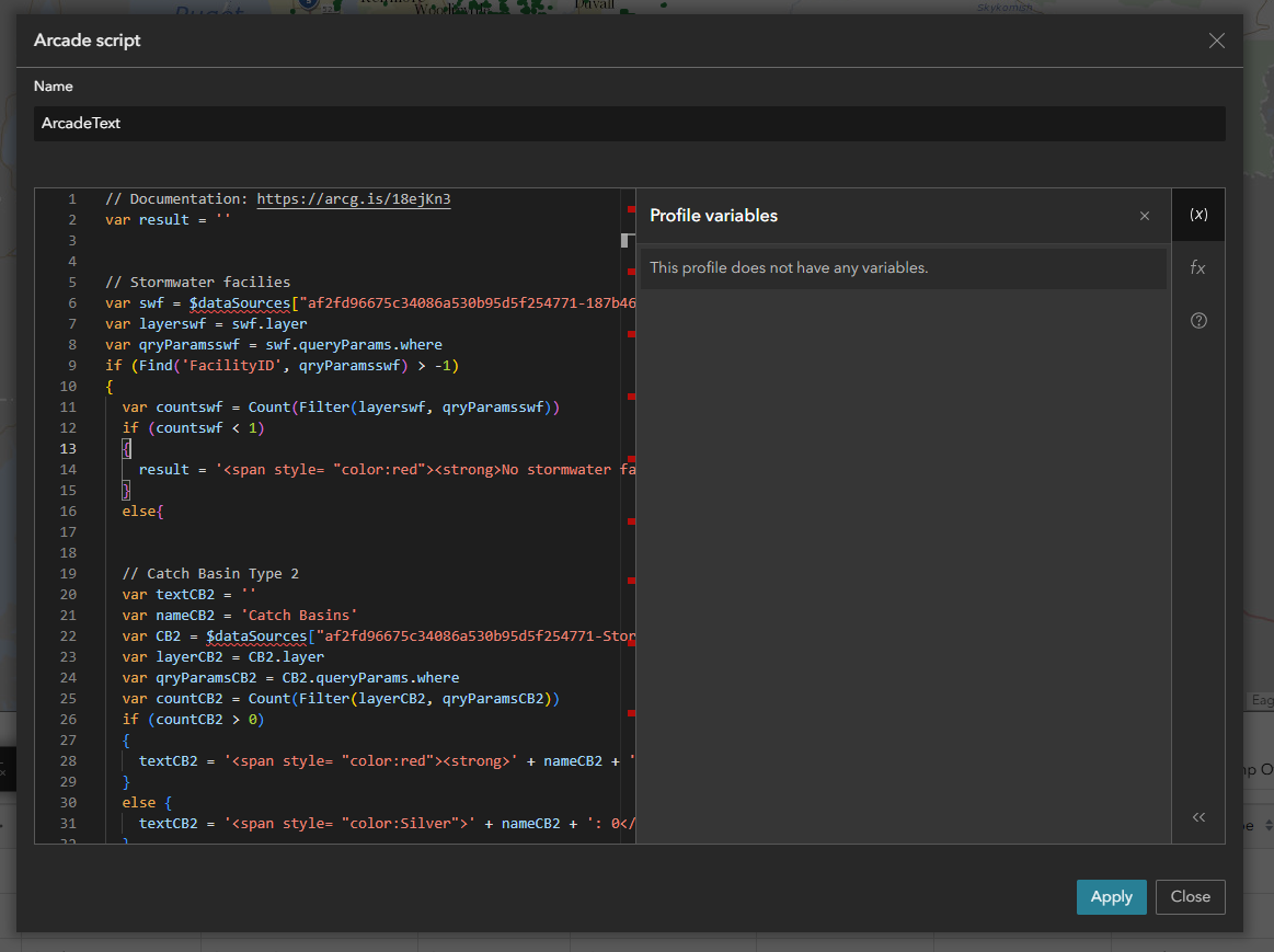

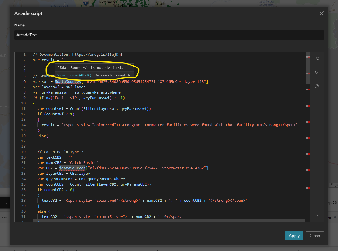

I used an Arcade expression that was connected to some layers in a Text widget in an Experience Builder app last week. The widget worked as expected. When I checked the app today, the Arcade expression wasn't returning anything. When I checked the widget's Arcade expression it was throwing an error on the $dataSources profile variable saying that it "is not defined".
Also the Arcade editor now shows that this profile no longer has any Profile variables:
Now, if I try to add another Arcade expression into this same Text widget, it just shows an empty script (before it had a built-in function and commented-out variables that linked to all of the layers I had defined in the "connect to data" in the Text widget configuration). If I try to add dynamic content, that works. If I create a new Text widget that is connected to just single layer, an Arcade expression works. But if I try to make an Arcade expression connected to more than one layer in the map, it again doesn't even recognize the $dataSources profile variable. The weird thing is that it was working fine a few days ago.

Thanks @EdwardMcFarlin , this bug should be fixed by today's update.
