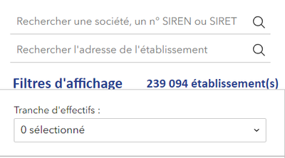

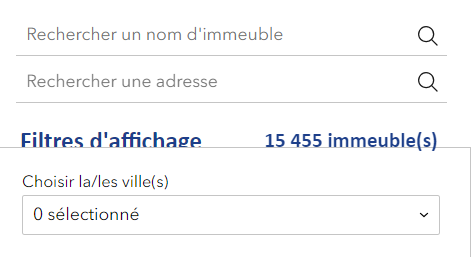

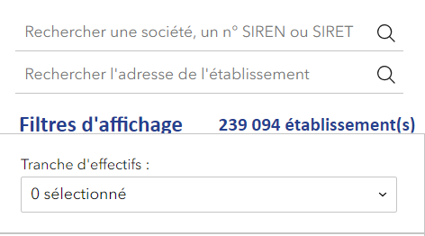

Hi guys,
Here is my problem : i've created one page with a specific structure and parameter the text on this page to be modified depending on the screen resolution (using vw instead of px)
i've use auto size of widget box to have the best application which can be adapted depending of the screen resolution.
No problem for this page :
I create a second page, with the same structure, the same parameter, but only different data and thematics and i'm blocked with one major problem : my blue text is cropped on the second page and I can't understand why...
Anyone have an idea to fix this ?

If those are built in widgets, Its difficult to know what to suggest with out seeing what is around those widget parts.  IF this was a custom widget, I'd suggest that the CSS used is not working both cases, but for a built in widget, this almost looks like the height of the second screen shot is 2 pixels smaller.  I don't know if its because of the inaccuracy of the clipping, or if it actually is smaller vertically, but that's the first place I would look
