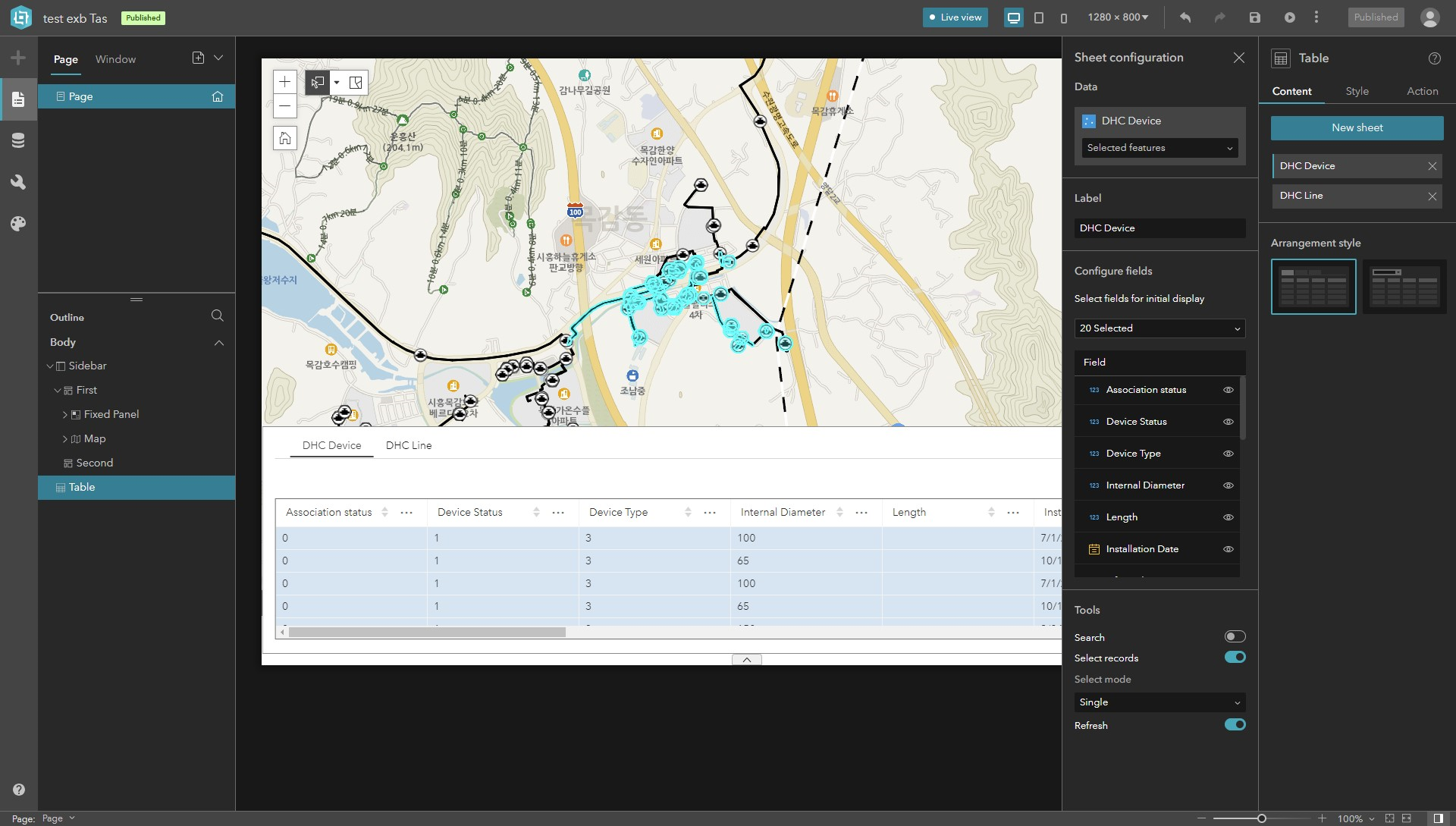

I am using Experience Builder with the Utility Network Trace widget to select connected features in certain areas. The source data is a UN Feature Service. Some fields use domains some integer domain codes and some are strings domain codes.
When I setup the Table Widget (Sheet Configuration --> Data --> UN --> Device (feature layer) and use Default as per UN_Default_DomainValues.png). The coded domain values are shown in the Table Widget.
However, if I change to use Selected features instead of Default, the Domain codes show in the table (as per UN_Selected_DomainCodes.png).
Could this be a bug? And is this planned to be fixed or already fixed in the latest version of Experience Builder? Or is it user error?

Hi @TasBarsdell, thank you for the feedback. I can also reproduce this issue from my end. This issue is being investigated now, and it could take some time as this issue may not be a data-specific problem.
Please feel free to raise an idea in the ideas channel or reach out to Esri support for assistance.
