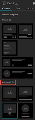

You can add any widgets into a Section - view. If you want to have a hover state, you can add a card widget into a view, and use Advanced template.

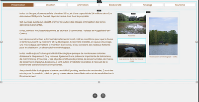

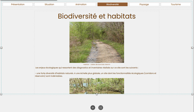

Hi and thanks for your reply but my problem with section is the height oh the section.
I need 6 views and each one have a different size so it cut the content :
I try to for the wiew but it's worst :

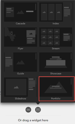

Plus, i need on the 2nd view to insert à brochure or a cascade.

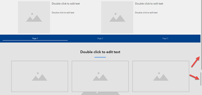

On the experience 1, you can add several scrolling page to make each page has different height. Enable header on each page and add a menu widget in header. For a better effect, you can check the option Stays at the top of the page when scrolling.
Publish the experience 1, and save the url of the published item.
On the experience 2, you can add a scrolling page. Add a screen group (screen groups take 100% view height, so the end users can always see the menu) using the last template (this template has main stage only):
Delete to only one empty screen left, and add a fullsize embed widget on the screen. Paste the url of the experience 1 into the embed widget settings.
Here is how the experience 2 finally looks like:
(view in My Videos)
However, one thing about this work around is that your app will have two scroll bars:
