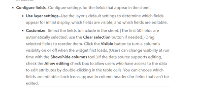

Use what settings, under "Configure Fields"? I have set visibility, display names, and order in Field Maps and the Visualization area in AGOL and nothing changes in the table. So what is that really connected to besides defaults or alphabetical? Yes, I have checked I am connected to the right layer in the right map for the Field Maps part.

EXB table widget:
https://doc.arcgis.com/en/experience-builder/latest/configure-widgets/table-widget.htm

@vic7oria When "Use layer settings", the settings come from your layer field settings from the popup settings in the Map Viewer.
