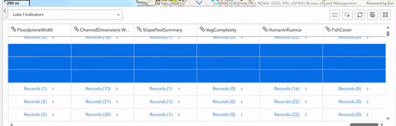

With selections and the related tables links both being blue you cannot see anything.  I am not seeing a way to change these colors?  For sure too much blue here.

Hi @DougBrowning, this issue has been fixed with a recent patch. You should be able to see the "Records (x)" text now. Thanks, Shen

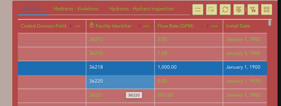

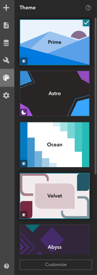

EXB has undergone an overall theme upgrade. Now, the selected color of the table can be configured by the user themselves. In the "customize" of "theme", you can see the Interactive element section. The selected state of the table will use a pair of colors from "selected". Each theme will have its default color scheme, and you can also configure the colors according to your own needs. Please check if the font color of "selected" here has also been set to blue, which makes it impossible to see the content clearly.

This does seem ok now thanks!
