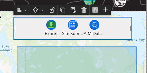

No matter what I try here I get text with a ...   How can I get it to show all the text and not cut it off?  Making the container wider does not work.  I see size for icons and button but not text.

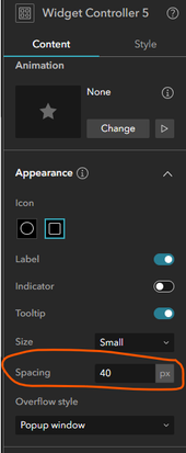

Depending on how long the titles are, you may be able to get away with adjusting the spacing:

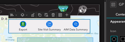

Doing this, I'm able to fit at least as much text as on the left here:

I know I tried that but messed something up.  thanks.
Works now

If your on Online, the latest update gives you some options. Selecting Custom for the Size unlocks the Spacing property.
And now you can make the Buttons farther apart.
You can also build your own Widget Controller. https://community.esri.com/t5/experience-builder-tips-and-tricks/the-diy-widget-controller-part-ii-t...
Edit: Not sure why I thought Spacing was unlocked by the new Custom Size option. It's been there for a while and it's there on the other sizes, too.
