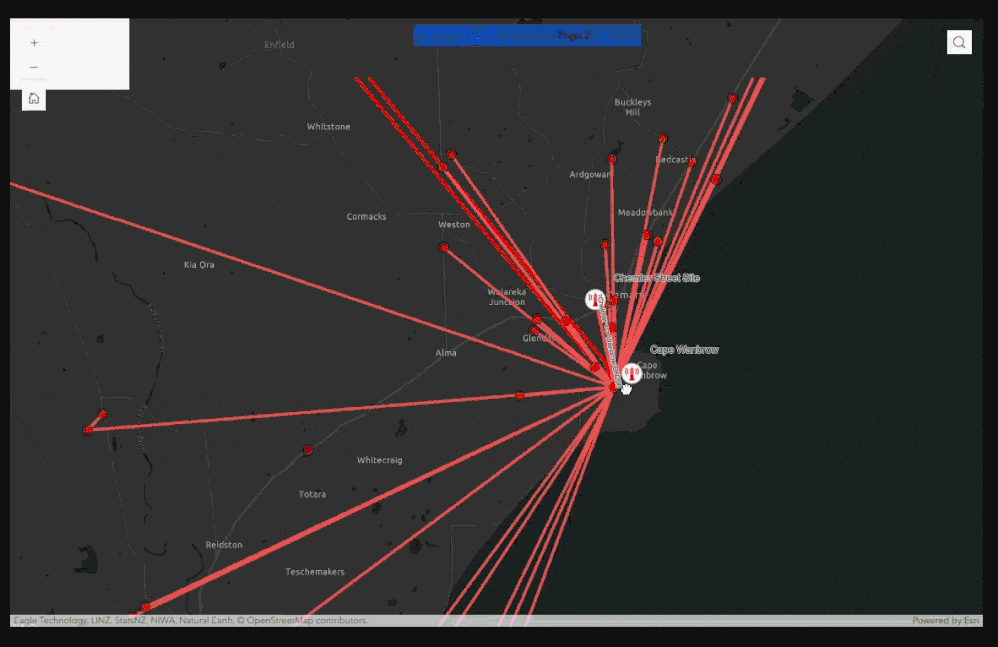

@JanetSilb_Spike  - You can use "action" on the map widget.
I have set up a quick example here.
Page 1 has a map and Page 2 has a different map.
Used the Action on Page 1 Map widget to zoom/pan same extent on Map 2 of Page 2.
Here is a gif in action.
Hope that helps!
