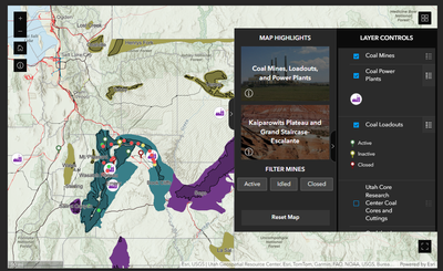

You can use the Map Layers widget to do that. This is an example of how I've used it. It has check boxes, symbology, layer names, and interacts with the Map widget.
You can see how this works on the Utah's Energy Resources site.

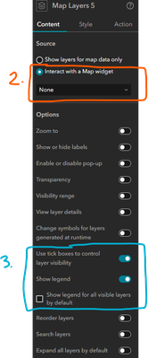

1. Add the Map Layers widget to your page.
2. In the widget settings under Content, make sure the "Interact with a Map widget" option is checked, then click the drop down and select the Map widget you want it to interact with.
3. Under Options, turn on "Use tick boxes to control layer visibility" and "Show legend"
  • When you select "Show legend," you also have the option to "Show legend for all visible layers by default"

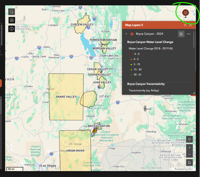

  • If you want to make the Map Layers widget a button "inside" the Map widget interface do the following:
    • Add the Widget Controller widget to the map.
    • Click and drag the Map Layers widget into the Widget Controller.
    • Use the settings in the Widget Controller for the button styling, size, and placement.RachelWillmore_7-1775670253132.png
