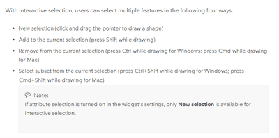

In reading the Experience Builder documentation it says:
I have a select widget with only interactive selection turned. After making an initial selection, holding shift to add to that selection or Ctrl to remove from that selection is not working. It still just does a completely new selection.

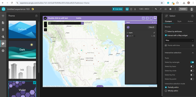

Hi @AdinaZucker,
It works well on my side. Do you use portal or ArcGIS Online?
