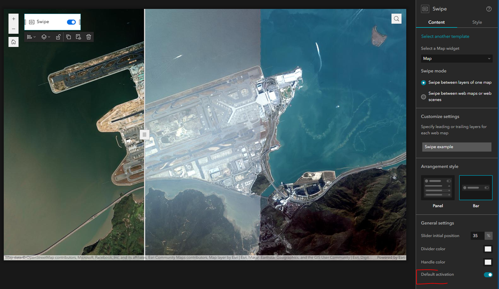

I think this is what you are all looking for?
See sample: Swipe example
When you configure Swipe, enable the Default action toggle under General settings.
