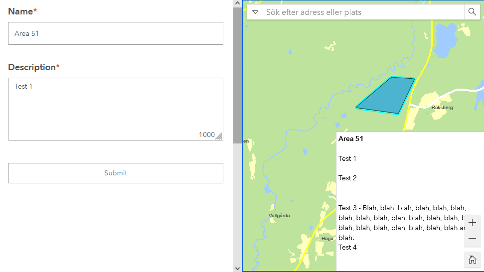

When building my experience i got an unexpected problem. When I had connected the map with the survey and added connections between the map attributes and survey fields, I realized that the line-feeds made the Survey widget ignore the rest of the text.
In the screenshot below, I've added a Card widget over the map (right side) to show the attribute info as it was meant to be drawn, with line-feeds. As you can see, the text in the surveys Description field end at the first line break after the text "Test 1".
Is there any more configuration needed for this to work or is it possibly a bug?
