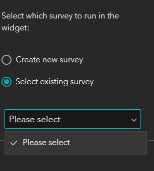

I am attempting to create a experience with the Survey123 widget but it does not list any surveys in our portal. I can create a new one and it creates it on the portal but I cant add it to a new experience.

I gave it a try and can successfully find the survey that I created in the 10.8.1 portal:
Could you double-check the following:
1. Make sure that the survey is created using https://survey123.arcgis.com/?portalUrl={your_portal_address}
2. Save and Publish the survey
3. Re-visit ExB app and see if you can access them in the dropdown?

I have just tried again as you and it hasn’t worked.  I can’t see any errors in the console; but have run it with fiddler.
This URL:
https://survey123.arcgis.com/api/survey/query?isShared=false&isPublished=true&token=XXXXXXXXXXetc
Returns this in a browser
{"error":{"message":null,"code":-1,"details":[]}}

I'm running into the same issue with 10.8.1 portal.  None of the existing surveys that i created show up for me.

I didn't get any further with this. The surveys are created by me and I am the administrator so I should have access.
