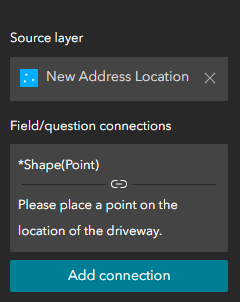

I did connect the survey and the map. It looks like this is the way to do it?
I tried adding the name and address fields to the connection to see if it would populate the survey, thinking that maybe if they put the point first, I would be able to finish the survey after they did, but it did not populate the existing form, although it did create a feature with the information that I supplied in it.

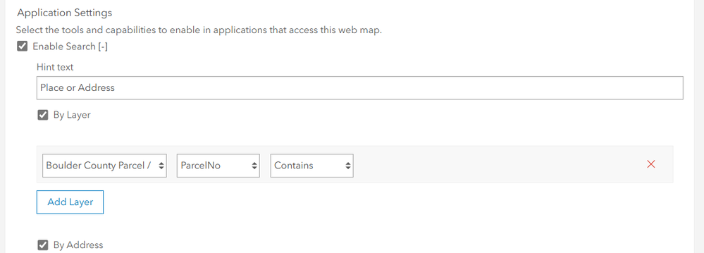

I wanted to investigate this a little more first. I found this blog that may help with the steps to setup your own web map in the survey: Survey123 Tricks of the Trade: Configuring survey ... - Esri Community
If you're able to use your own web map in your Survey123 form, then the search toolbar in the Map question of the survey should allow you to search against any layer you configure in the web map's Application Settings (from the Settings of the web map's item details).

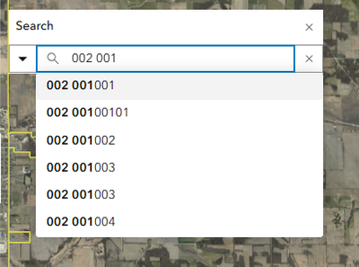

JenniferBorlick
OK. So I figured out how to set the search layers in the map settings and tested it out and it works.
