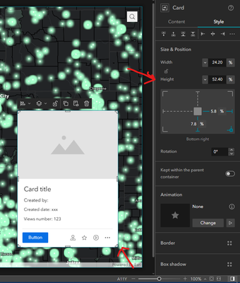

Good morning,
Is there a way to resize the whole card widget?
I would like to change the Height.
Thanks
JeffreyThompson2
MVP Frequent Contributor
Cards should be resizable like any other Widget by grabbing and dragging the white handles around the Widget or setting the parameters in the Style Panel.
GIS Developer
City of Arlington, Texas
SanchezNuñez
Good afternoon @JeffreyThompson2
In my case in the Style tab shows this message "This widget does not support style settings."
Thanks
JeffreyThompson2
That means you have your Card inside a Widget Controller. Your size options will depend on whether you are using a Floating or Fixed Panel Arrangement. If you chose Fixed, you will have size options in the Widget Controller Settings Panel or you can click and drag to resize, but the size must be the same for all the Widgets in the Widget Controller.
If you have a Floating Panel, you can only use the click and drag method, but you can set a different size for every Widget in the Widget Controller.
