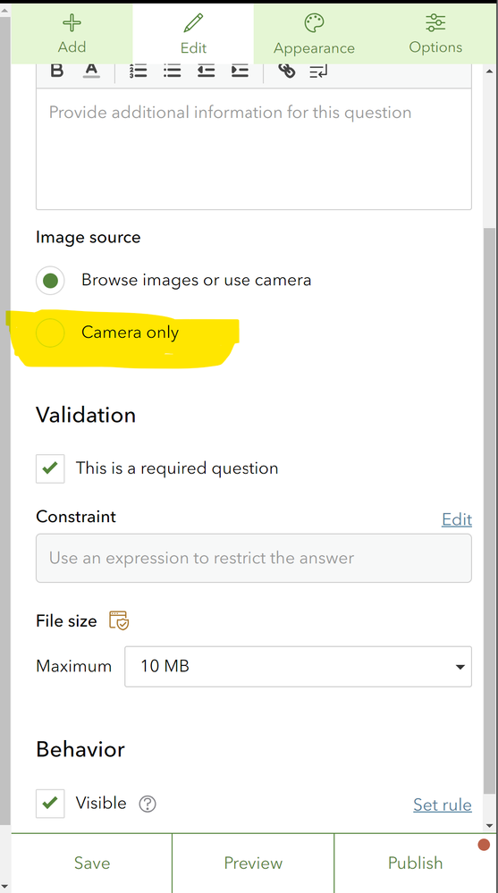

UbaidGul_opaz
Have you used the highlighted option here while creating the survey form. Use camera only option. Hope this will solve the issue you are facing.

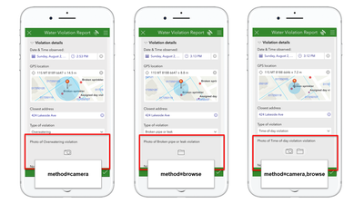

Thanks for sharing your question here. Have you tired the method=camera in the body::esri:style column?
Here is what an XLSForm looks like if you want to force users to submit a new photo from the camera:
type name label body::esri:style
geopoint location Location
image image Photo method=camera
