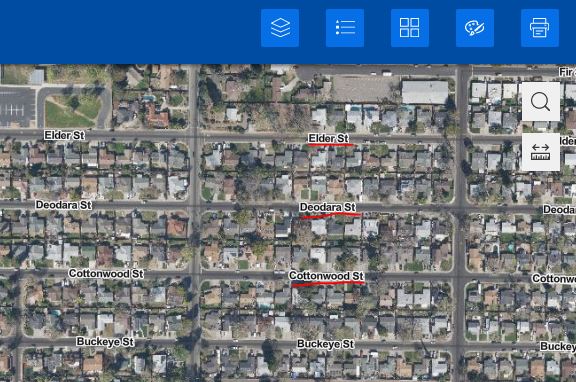

I have a street layer sitting in a map widget within Experience Builder. I'm trying to use the print widget to make a PDF of the street layer including the labels/street names. When viewing the street layer in Experience Builder's view/edit mode, everything looks good. I can see all of the street labels at various scales. However, when I use the print widget to create a PDF, all of the street labels are missing.

Above is a screenshot of the layer in view mode in Experience Builder. The labels/streets are viewable.

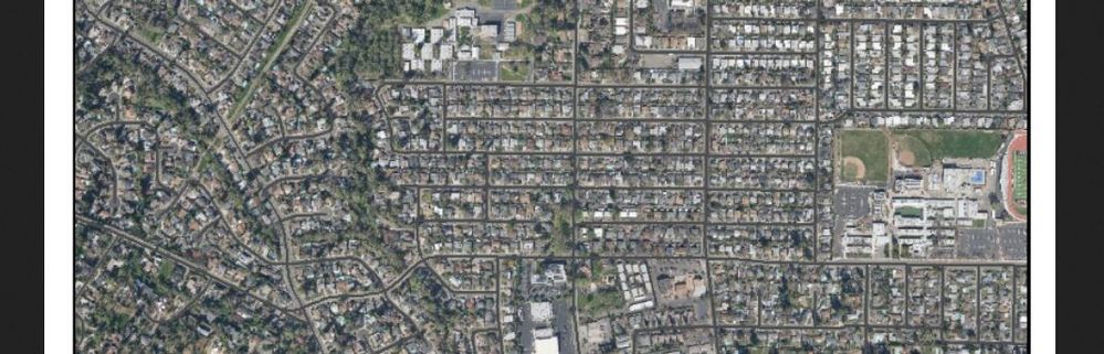

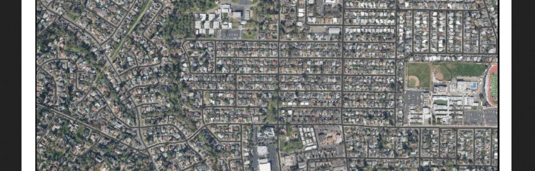

Above is a screenshot of the print widget PDF. The labels are missing, but the street layer is still viewable.

Thanks for taking the time to review my question. I appreciate it. To answer your question, I have tried all scale options while printing. Whether it's "current map scale" or "current map extent" the labels for the streets disappear once the print widget PDF is created.
