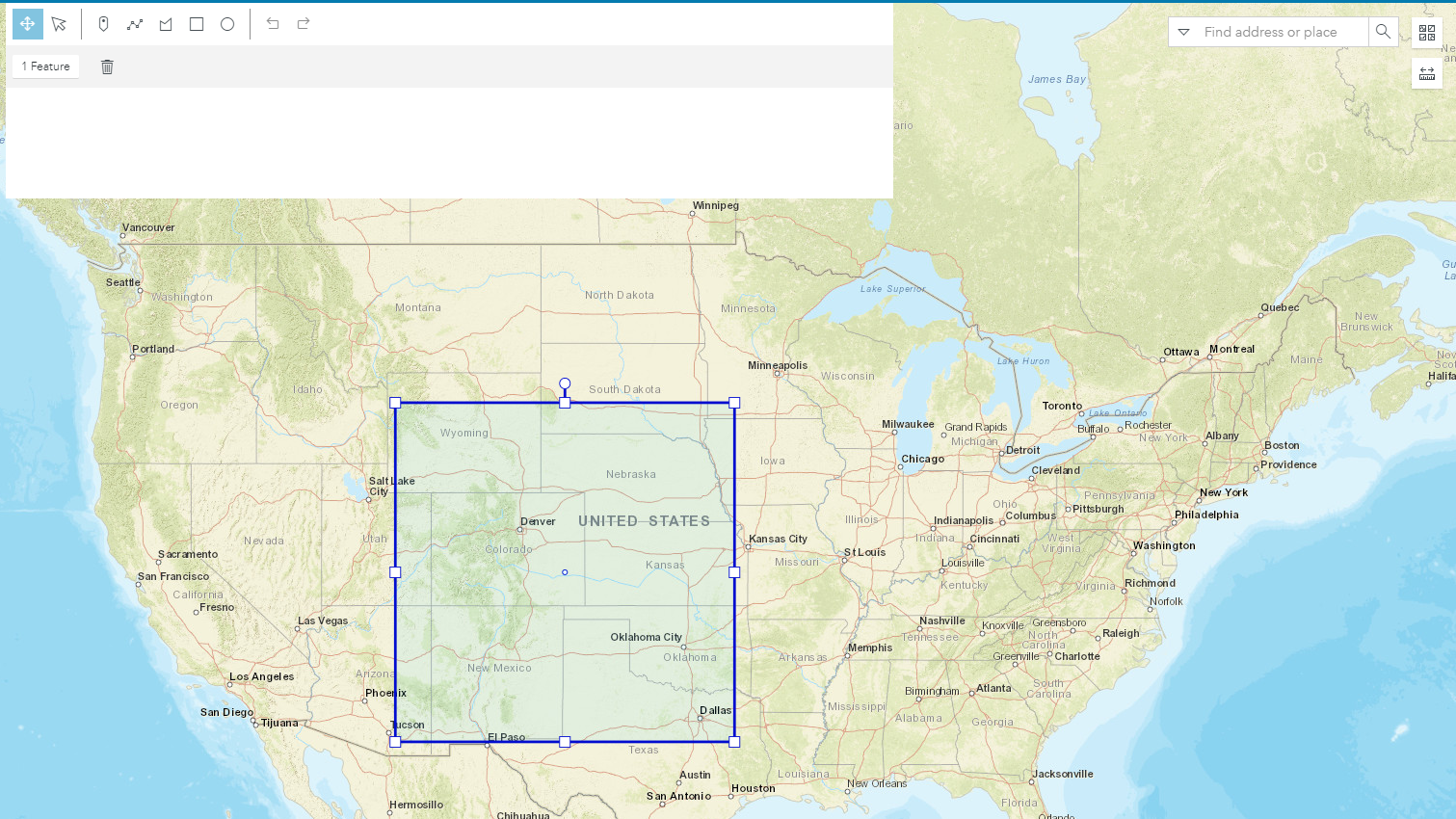

Hello all,
I am working to create a custom widget with the JS API Widget Wrapper by importing the Sketch widget into the "client/your-extensions/widgets" folder of my ArcGIS Experience Builder Application. The widget is working correctly, however, the resulting graphic is not visible when finishing a Sketch. A selection box is highlighted in my Map view but the physical graphic is not visible and cannot be rotated or modified (Image attached below). Please let me know of any possible solutions to this issue.
Sketch output not showing graphic in custom Experience Builder widget.

Hi Henry Pelesh, It looks like you've added a line:
const layer = new GraphicsLayer();
that is correct, it creates a GraphicsLayer, but you have not added that layer to the map. After that line you should add:
jmv.view.map.add(layer);
After you add that line, the drawn shape will stay visible on the map after you draw it.
Henry_PeleshBW
Gavin Rehkemper‌,
Thank you very much! I must have missed that line of code. I appreciate your help! Problem solved!
